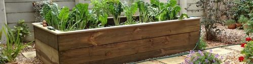

The first of 3 raised garden beds I’m making. Made from cypress, hardwood sleepers and some hardwood from palletsThe first of 3 raised garden beds I’m making. Made from cypress, hardwood sleepers and some hardwood from pallets

Looks great @moshiach77, well done to you!

looks great. How do you cut that wrought iron ?

Fantastic work @moshiach77, many thanks for sharing this project with the Workshop community. We look forward to seeing the other two raised beds you are making.

Thanks for joining in the discussion @fishingfan. I'm sure @moshiach77 will get back to you as soon as possible and answer your question about cutting the corrugated sheeting. I'll also tag some other handy Workshop members like @Brad@ProjectPete and @redracer01 for you who also might have some advice.

@fishingfan
Traditional way is to use niblers, I have a metal cutting circular saw and you could also use a multitool or a jigsaw. A cutting disk in an angle grinder will do it but you will have to live with the bur it leaves and either cover it or clean it up and keeping the cut straight can be a problem. Snips if you like a manual option.
Another useful thing is a guide clamp. https://www.bunnings.com.au/craftright-50-aluminium-clamp-and-cutting-guide_p5860136
Trusted Contributor
Re: Raised Garden Bed
Nice work @moshiach77 - given the fact the cut ends are covered/concealed, I'd probably just rip through it with an angle grinder and give yourself an opportunity to practice cutting straight lines on wonky material.
Otherwise @Brad's suggestions all work too :smile:

@fishingfan I used 1mm cutting disk on an angle grinder and clamped a piece of angle iron to the sheet as a guide.
