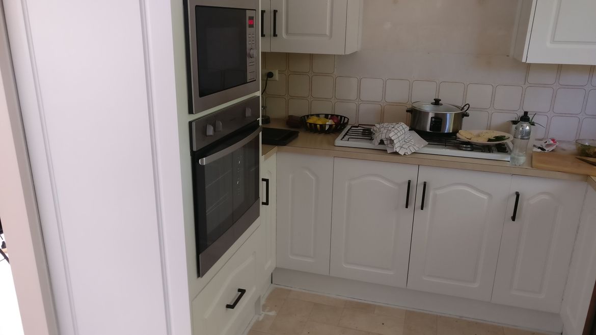

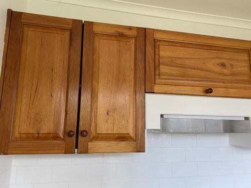

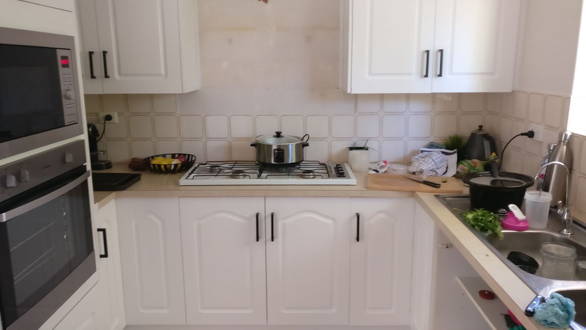

I am currently using the renovator range to paint timber stained and varnished kitchen cupboards. The results are good but the underlying colour bleeds so badly that I needed two coats of primer/undercoat to stop the bleeding. As the renovator range is touted as requiring no priming "generally" it was a waste of money buying it. I should have bought the standard water based dulux enamel which does require priming but is about $20 cheaper for a 2 litre tin. I will post some shots later.

Re: Dulux Renovation range
Hi Caron, I am no expert on these matters - we learn from experience so my opinion is exactly what it is - an opinion! you will see from the photos that their is a radical difference in colour change and a pro painter probably would have said it was always going to bleed. In your case you are painting on top of cream which should not bleed too much even with a white top coat. I would stick with the renovator range going onto laminate because it is designed for that. If you opt for the standard enamel you will need to prime and the primer will need to be designed to adhere to laminate. If it doesnt the whole thing will peel and chip off. I used gloss which doesnt come up real glossy even though i used the 4mm nap roller as advised.
Also if you prime there is at least 3 coats going on which is tiresome.IMG_20200331_083130.jpgIMG_20200331_083107.jpgIMG_20200325_110424.jpgIMG_20200314_125134.jpgIMG_20200226_133010.jpg
I will post a couple more when the doors are installed. The oven has been replaced I will post a shot of that.
