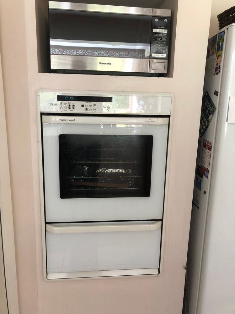

I am trying to find a second-hand oven to install (family member is an electrician) but it appears as though the current oven is an unusual size. The current cavity is 62.5w x 96.5h. It appears as though most double ovens are now 59.6 x 88.8 or 59.6 x 108.3. The smaller of the two would leave quite a gap and it is mounted in the wall (gyprock) not in a laminex cavity. How would I make this look a little more finished?

I doodled out a plan to fit the 59.6 x 88.8 oven.
Then I wondered, are they the external dimensions of the oven - or the cavity dimensions?
Do all the ovens have this coverage perimeter strip - what width are they?
Dimension?
My plan is glue, screw, 70 X 45 battens, gyprock, 30 X12 oak trim, plaster, sanding and paint.
Doodle

It's fantastic that you've received excellent advice from @Noyade. I agree with the recommendations made and the methods suggested are an excellent way of covering the gap. Have you chosen your second-hand oven? If it is a modern oven and you have the external edge dimensions of the oven front, you can have it finish flush with the cavity wall.
Have you considered getting a new oven instead of purchasing a second-hand one with food warmer? The cavity can then be modified and the gap above can be used as a shelf. However, if the oven front is too big and finishes on top of the gyprock any gaps can be filled with a piece of plasterboard, filled and painted over. Please let us know once you have the oven dimensions. We'll then be able to offer you more recommendations.
