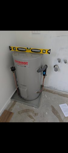

Hello,
I am building a kaboodle kitchenette.
The corner cabinet is to have a hot water tank inside it.
The drip pan/tray is the same depth as the cabinet. Meaning I can't install a kickboard.
What are my options here?
I didn't even think of this been an issue.
I really would like to have the same kickboard look across the whole kitchenette.
Someone said I could pack out the back of the kitchenette to bring the cabinet forward.

Hi @LeopoldProjects could you please send through another photo further back showing the entire front of the hot water service and drip tray..

There you go. @Nailbag

Good Morning @LeopoldProjects
From the first photo I had presumed the hot water tank and cupboards were allready insitu.
I was thinking about reducing the size of the tray for the hot water tank and espicially now that it is on its own. (Have a new one made or modify the one that is there)
Same width just 5omm shorter and then your kickboard can be put in.

Yes I would love to shorten the tray.  Would make life so much easier.  Would have to modify the one there but I have no idea on how to do that.

I was hoping there would be a way to shorten tray without removing tank.  As it is all plumbed in.  I don't plan to move it.
Hence why I was going down the route of bringing the cabinets forward to allow a kickboard in front of the drip tray.
