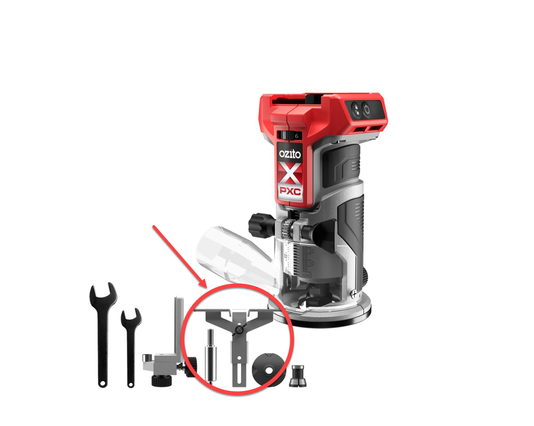

Most routers will have a guide that you can run along the edge of the timber to make a consistent groove in it. For example, this Ozito PXC 18V Brushless Trim Router PXBLTS-018 has one here -
If your router has one, this would be the simplest way to ensure you cut a nice, clean groove. If not, then you would have to set up a guide to run your router along. Something like the guide used in How To Cut Laminate Benchtop would work.
You'd have to use a straight cut router bit, like this Ultra 6.4mm Straight Router Bit, in the correct diameter for the groove. You would then just set the router to the correct depth and carefully run it along the timber.

Then once the frames are built, use a trim-router such as what @JacobZ suggested with a straight bit with follower bearing. The bearing helps to keep your cut dead straight and prevent over cutting. Follow this video I made which essentially if the correct method for making a picture frame. But your inserting a glass or PVC panel instead.
