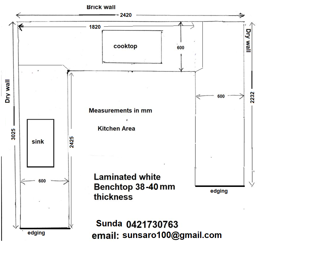

I have a couple of concerns. First, I wonder if my cuts will be as precise as those made by a professional. Additionally, as Dave mentioned, my kitchen walls are not completely square. If I cut the benchtops to size based on my measurements (please see the attached diagram), I might make a mistake, especially with the centre piece. If that happens, I will need to replace it with a new piece that is cut correctly. For the two side pieces, I plan to leave extra margin on the ends before making the final cuts, so I can avoid having to replace them in case of errors.

When planning the position of the benchtops, there will be some wriggle room for the errors of both how square the wall is and any waves in it due to the studs not being plumbed. This wriggle room comes from the tile underlay, adhesive and the tiles themselves covering the gab. Assuming of course thats your splashback build. Plus there are some nice trims available to further cover any additional gaps in a worse case scenario. The most important thing is placing the benchtop squarely to the finish wall and cabinetry. This balancing act may result in the front over-hang less or great than standard.
Unless you need to do a rip cut, I'm not sure what purpose the table saw will serve and a circular saw being hand operated will never make a cabinetry accuracy straight cut regardless of how good you are. So in answering your question, I don't believe your cuts will be any where near as precise as the professional ones. Remember you also have the additional challenge of being a novice DIY'r attempting to make a first ever advanced series of cuts with nothing to practice on.
Having said that, it simply comes down to your level of acceptance of finish to DIY vs cost for a precision machine cut. It might need something like an epoxy filler in your joins.

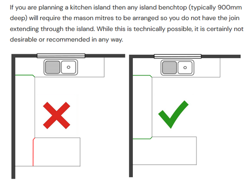

... seems to be suggesting the mitre on the right of your drawing should be running with the cooktop bench?

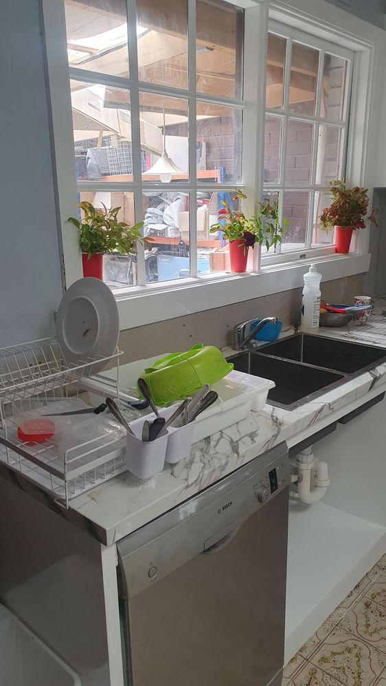

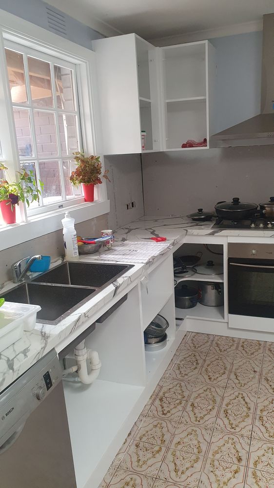

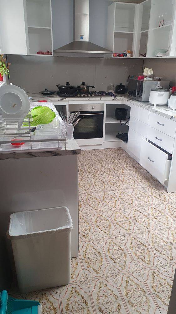

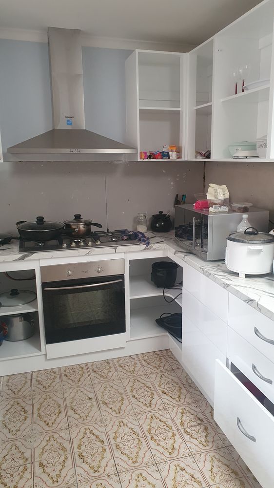

I apologise20260120_155309.jpg20260120_155228.jpg20260120_155223.jpg20260120_155236.jpg20260120_155243.jpg for the delay in expressing my gratitude to all of you who took the time to respond to my question. I was on holiday for a month and returned home in the first week of this month. Thank you all for your answers; I truly appreciate them. The responses were very informative, and most of you advised me to have the benchtop cutting done by a professional. I followed your advice, and I’m happy to report that the kitchen is now 90% complete. The measurements were accurate when I ordered the benchtops, and they fit perfectly during installation. I still need to make and install the cabinet doors, and the splashback is expected to be ready by next week. After the splashback is installed, I will focus on the tiling. The satisfactory result is the reward for my efforts.
Please take a look at the pictures of my kitchen now.
