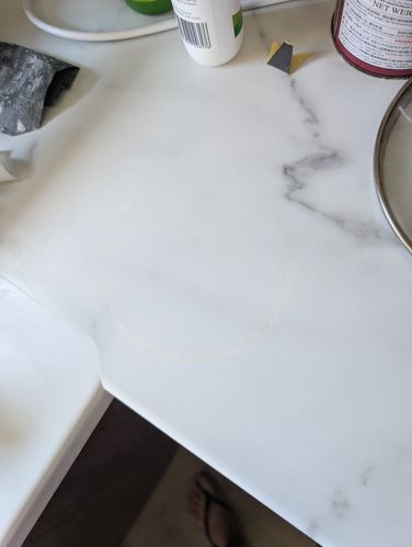

Hi Team,
I have a laminated stone benchtop which is having burnt mark shown in attached photo.
I would like to know how to remove this burn mark.
Kindly someone guide me to the right contact person or advise how to fix this.
Thanks,
Hana.
Welcome to the Bunnings Workshop community @hanamanth. It's wonderful to have you join us, and many thanks for your question about repairing a laminate benchtop.
Unfortunately, there's no real way to repair the damage as the laminate has been melted and scorched. You'll find many previous discussions on the subject that you might like to read through; there's plenty of advice and solutions from our members.
Since there is no way to restore the look of this area, you typically are limited to options like painting the benchtop. Fortunately, we have products such as the Dulux Renovation range that are perfect for this task. Many of our members have successfully transformed the look of their laminate benchtops. Here's a helpful guide: How to paint a kitchen benchtop with Dulux.
Hi thanks for your response
I was confused as to whether it’s a laminate or solid surface or corian counter top because it doesn’t have a particular shiny coating
It thats the case is there any material I can purchase from bunnings to try removing the burn mark ?
If you take a look underneath it @Shivanir, if it has exposed timber particle board, then it's likely laminated.
If it's natural or reconstituted stone, you might like to try Hillmark 375ml Stone Kleen And Protect Marble Granite Cleaner to see if it can help lift the marks.
