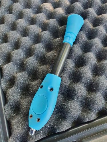

I've also had success with those glue pens that require ultra-violet light to set...
