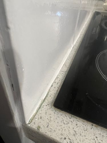

How to neaten edging of benchtop & painted tiles?
I have painted my kitchen splash back tiles white now I need to neaten up the edge where it joins the bench top. Any suggestions?
Re: How to neaten edging of benchtop & painted tiles?
Great work @oliviapatch.
Since you likely removed the silicone sealant from the corner as per the tile paint application guide, I recommend adding it again, which will seal the corner and improve the look. Here's a helpful step-by-step guide: How to apply silicone sealant
I'd suggest you wait a week after applying the tile paint before using masking tape over it when sealing the corner; any sooner, and it will likely pull the paint off. Remember to remove the tape immediately after applying the sealant.
