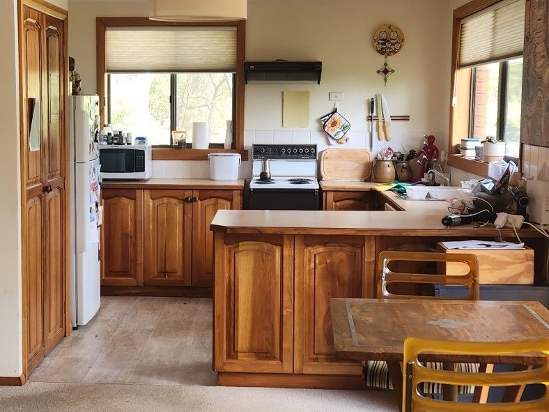

I'm a bit confused with the options for painting TIMBER kitchen cabinets. There are some great examples on here but some seem to use primer, some don't, some top coat, some don't so I thought I'd put down what I was thinking to get some clarification as to whether I'm doing the right thing!
I was inspired by Nicole Herricks transformation https://www.workshop.bunnings.com.au/t5/Featured-Projects/Kitchen-cabinet-makeover-using-paint-spray....
The Dulux Reno Range seems a good option (as its specifically designed for cabinets) but what is the real difference between that and using a Dulux Aquanamel like I'd use on my trim? I also understand the Dulux Reno Range has to be used within a certain number of days once the additive is added so I wonder if this is a limitation if I have a hiccup or want to spread the job out (I may want to do the trim and island cupboards first but there may be a delay in doing the cupboard doors.
Some people seem to use the Dulux Reno Range primer but some, like Nicole, use the Zinsser primer (which certainly gives a better base coverage for the colour). What is better?
Also, some use the Dulux Reno Range clear coar as a final coat but some don't bother. Is the final coat needed if you've done say 2 coats of Zinsser primer and two coats of colour?
Sometime I think I watch TOO many videos haha.
Some suggestions/guidance would be appreciated to put me on the right track.
