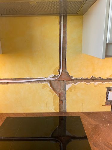

I have a tiler coming to do a splashback and I need to cover up the cables. What’s the best option? Cheers

Thank you, I did message him and he gave me a long reply of why they are compliant. They also had Energy Safe Victoria do an inspection and issue a safety compliance certificate. He said they can be rendered over so now I’m confused 😅

The installation of electrical wiring looks compliant this is how its  done.
Dont worry about plastering over the gaps and wires yourself for the tiler.
The competent experienced tiler will know how to handle this job.
