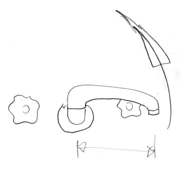

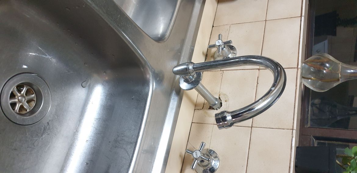

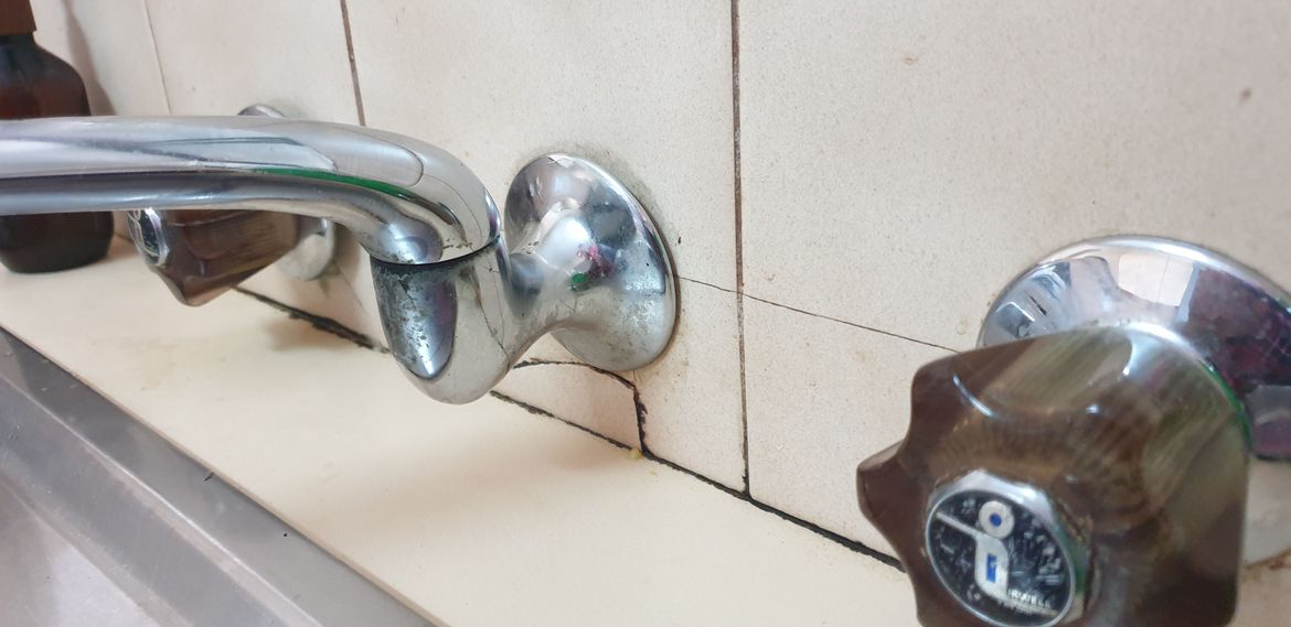

Hi, I need to replace the kitchen sink faucet but I can't use a spanner as the faucet base in circular and slippery. It's too tight to come off with bare hands. What tools should I buy from bunnings to remove it?
How can I remove it?
Thanks

Somewhere along the base of the spout is a grub screw access point. It is sometimes very small and is often covered with grease making it almost invisible. When you locate this spot, you'll need to use an Allen key to remove the grub screw that is holding the spout in place. Keep the grub screw in a safe spot so that it does not get lost.
To remove the spout, you'll need to pull it upwards to disconnect from the wall base. It might be necessary to wrap a rag on the spout if it is very slippery. Once the spout is removed you can now turn the wall connector without hitting the sink or benchtop.

"I can't use a spanner as the faucet base in circular and slippery"
I've assumed you can't budge the wall plate?
And once off - we're throwing it all away and replacing it?
First suggestion - as per Eric above.
Second suggestion - turn the spout to the right and use it as a lever - and rotate to the left - anticlockwise. If achieved - swing it back to the right and repeat...
If still no success - please let us know. 🙂
(*Disclaimer - I'm not a plumber)
Thanks Eric, using a pipe wrench worked for me. I still couldn't locate the grub screw so I ended up cutting the top part of tap using an angle grinder.
Hi Noyade, using a pipe wrench worked for me. I tried to use the spout as a lever but it felt like it wasn't strong enough to hold the pressure so I ended up cutting the top part of tap using an angle grinder.
