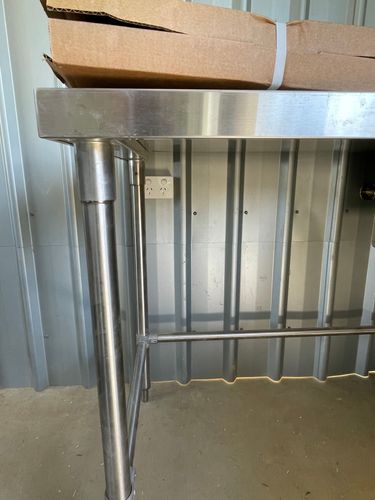

I have a pic which shows the legs of the bench against the wall and concrete floor.

The  correct solution really  is what is the plumbers expecting? What  will they call job done did they say any thing?
1)Well one possible thing is to attach legs to the floor think like a round curtain rod holder that can screw into floor  with screws .  i would re reluctant to do this but drill 10mm holes in floor so leg point drop into them.  This will stop  bench moving but not tipping.
2)Those 2  rows of screws in the colurbond looks like the  frame underneath.
You could undo a couple of screws and use a metal strap around  bench legs and use longer screws into the existing holes to pull bench to the wall.
3) Probably best solution use  L  (right angle brackets)  attached under the table  and to metal wall panel with  no frame behind it.  (But that will  mean hole through table top and this may not suit you.
Well thats for starters see  if that inspires you to more   ideas

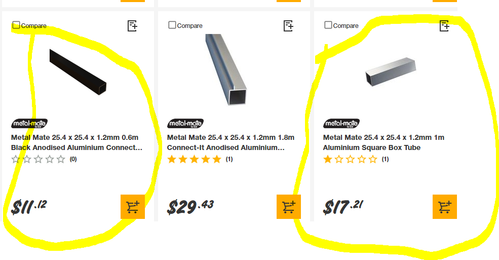

@Jewelleryrescue yes @EricL can draw. @Sunda I agree with Eric, you could use aluminum square tube with end caps, instead of timber (no painting required), available from Bunnings
