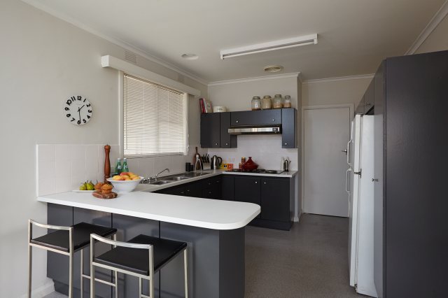

I immediately noticed that your kitchen is very similar to one in a house that Bunnings purchased and renovated from top-to-bottom.
Here's a before shot:
And an after shot:
There's a handy before and after slider here (as well as links to individual projects for achieving the look) - https://www.bunnings.com.au/diy-advice/kitchen/makeovers/fresh-start-kitchen
And you can find more inspiration here - https://www.bunnings.com.au/diy-advice/kitchen/makeovers
Hope that helps get you started.

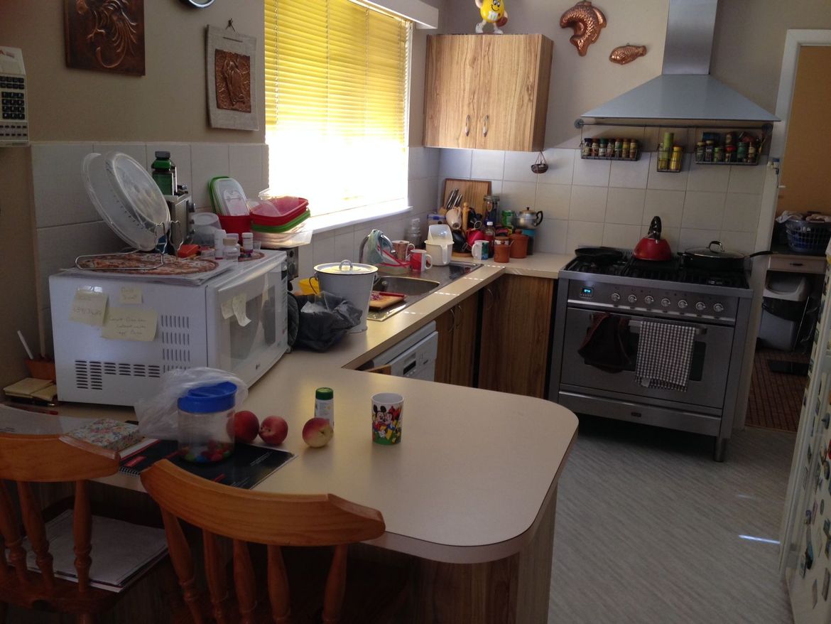

Most helpful Jason - unfortunately our kitchen is narrower than this one & 2 doorways

house plans attached - garage has been converted to living area so lounge/dining/garage is one big open area now (the plan attached needs to be mirrored if that makes sense!!) Laundry faces north. Yes the kitchen is a tight area thats why I'm looking for ideas. Want to move the kitchen bench as close as possible to the dining room window

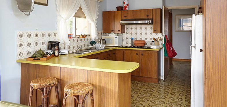

By the way, we inherited a 70s-era kitchen when we bought our current home. Here's what it looked like:
You can see what we did with it here - https://www.workshop.com.au/t5/Kitchen/What-would-you-do-with-this-kitchen/m-p/411
We've recently kicked off another discussion about renovating a 70s kitchen that you might like to follow - https://www.workshop.com.au/t5/Kitchen/Kitchen-Renovation/td-p/21803

Time to make some hard choices. I suggest removing the breakfast bar and the cabinet next to it and putting a pantry where the microwave is currently placed. I suggest the biggest you can fit in. If theres nothing next to the fridge I suggest a breakfast nook where the microwave can live in. This does 2 things, it eases the flow of traffic into your kitchen. No more bumping into each other. You automatically gain more storage space. If you buy a split pantry with drawers its a win win situation. Send me the dimensions of the kitchen and I'll sketch it for yah. Oh and draw the size of that laundry as well and well see if theres anything we can do about that. Cheers! My apologies should have clicked the next page duh!

Here are my suggestions. Please note that the drawings attached are not to measure and are for idea/illustration purposes only.1. I suggest using flat pack kitchen systems, makes it easier and a lot cheaper than custom made kitchens. Remove the small breakfast bar. By doing that you open the kitchen up and it makes it easier for people to come in and out and there is no awkward dance who goes first or people bumping into one another.2. Move fridge to where the microwave currently is. This will provide you with the opportunity to place a large pantry and a mid sized one next to one another. This configuration I've made for maximum storage. Under bench microwave and the breakfast nook is now on the right.3. Remove that orphan wall cabinet and turn it into shelves. Easier on the eyes and does not distract from the over all look. But even this re-arrangement looks so tight and crowded. I suggest looking at configuration 2. Its so much more open and gives your kitchen good flow.
Front with fridge moved to left side from original spotRemoved existing pantry and placed new pantry set and cabinet set as new breakfast areaNo more single cabinet, yes the golden brass gold fish can stay or was it koiThis shows you where the fridge would go. Not the best layout but gives you maximum storageThis is configuration 2. I swapped your fridge and your cooking range positions. added a pullout pantry next to the fridge and an appliance nook to park the kettle and toaster.Cooking range side maximizes cooking and prep space for those big meals. No more pushing for bench top work space.Even more bench top space and you get wall cabinets. This is the new breakfast area.
Wow - thank you so much. I've had numerous kitchen people here to give me ideas and quotes but they have all just redo what we have already even though I've asked for more storage and bench space plus their ideas......WIll ahve a very good look at this now.
