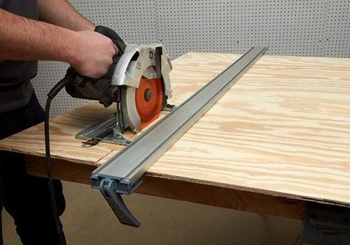

If you use a circular saw, set up a "fence" as shown in the photo I've attached. This will allow you to run the edge of the saw along
the fence to help you get a straight cut. This will also allow you to do a shallow first cut and then a 2nd cut at full depth along the same line. The shallow cut should reduce the chance of busting out the edges. There are videos on YouTube about setting up a fence and also how to cut melamine.
