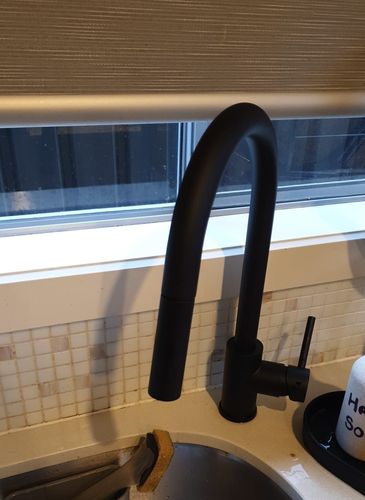

Hi everyone,
Just reaching out to see if anyone has clues on what to be done next.
Last night, bought and installed brand new Mondella Cadenza Matte Black Vege Spray Sink Mixer, however since then we are noticing slight metallic taste. Did some google searches and found the issue is not uncommon, thinking of waiting for few days before returning it at Bunnings. Any suggestions?
Thanks in advance

Hello @talexpat
Welcome to the Bunnings Workshop community. It's fabulous to have you join us, and thank you for sharing your question about your mixer tap.
This phenomenon often occurs when chlorine in the water reacts with the new copper inside your tap. It will eventually go away in time as a natural coating of scale forms inside the tap sealing the copper. As a temporary solution, I suggest getting a Stefani 8.5L On Bench Water Filter to filter out the metallic taste in the water.
A stronger alternative would be the Stefani 10L Glazed Ceramic Water Filter. It reduces chlorine, bad taste and odours and is distilled by a multi-layered microporous purifying ceramic candle.

Hi Eric,
How long is a reasonable time to wait for the taste to dissipate? We have had ours installed for 4 weeks and our water still tastes awful. We didn’t have any issues with the old tap and still no issues with other taps in the house. Cheers.

Hello @Mick70
Welcome to the Bunnings Workshop community. Thank you for joining the discussion.
Unfortunately, there is no set timeline when the lime scale coating will form inside your tap. The main culprit is the water that is passing through the tap, its's creating a chemical reaction that is producing that metallic taste. Even if you were to change sink mixers the reaction would still be there as the majority of tapware is made out of brass.
My best recommendation for the meantime is to use a Stefani 10L Glazed Ceramic Water Filter, it uses a Low-Pressure Ceramic Cartridge Candle that removes foul taste and odour in the water.
