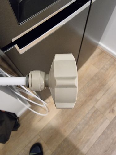

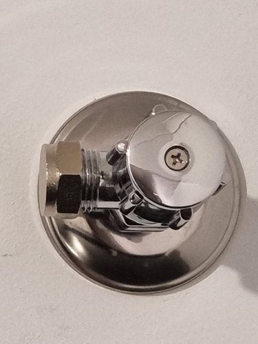

I have an adaptor from my fridge that connects to the tap. Unfortunately it is too big (20mm) for the water point outlet (15mm). Is there an adaptor that can convert that 15mm outlet to a 20mm outlet to allow me to connect it?
Also, what sort of tool do I need to properly secure and fit the adaptor as well as the connector? I have no DIY experience at all.

Adaptor
https://www.bunnings.com.au/kinetic-20-x-15mm-chrome-plated-brass-bush_p4700138
Sealer
https://www.bunnings.com.au/enduraseal-50ml-liquid-threadseal_p4920453
Thread tape
https://www.bunnings.com.au/kinetic-12mm-x-10m-white-standard-thread-seal_p4920185
You only need sealer or thread tape not both, sealer is a bit more novice friendly but at a higher cost.
Shifting spanner
https://www.bunnings.com.au/craftright-300mm-adjustable-wrench_p6110468
Shifter should only be used to remove the cap ( make sure the tap is off) and to screw on the adaptor and make sure the thread is clean before using the tape or sealer. Fridge side fitting should screw on by hand and seal against the rubber washer, no tape or sealer should be needed for that.
