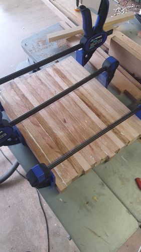

I cut 19mm thick Tasmanian Oak into 30mm strips on the table saw.
Turned these strip's on their side so that the board will have a thickness of 30mm.
Arranged strip's to make approx. width of 300mm, the Max width of my Planer.
Glued and clamped tight for 24 hours.
Ran through the planer/thicknesser until smooth even surface.
Gave a sand with 120 and 240 grit.
Rounded over the edges with a router.
Gave another 240 sand over the sides.
400 grit sandpaper all over.
Screwed on feet.
Finished with a food grade wax.
