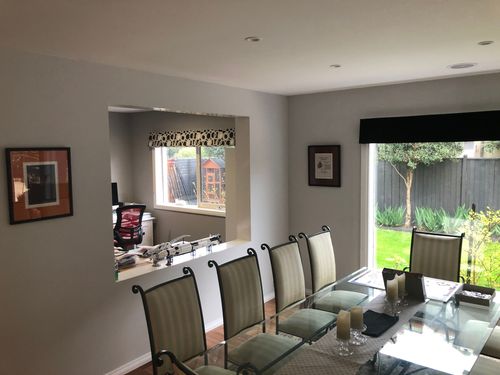

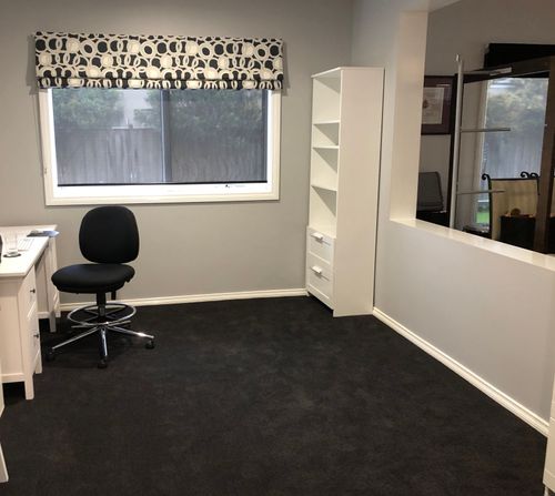

I purchased this house 6 yrs ago and the void between the dining area and the study always bothered me. I didn’t like the idea of shutters because it would enclose the spaces, so I drew up this plan for open shelving, contacted a few builders, who never responded.

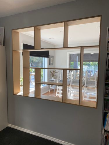

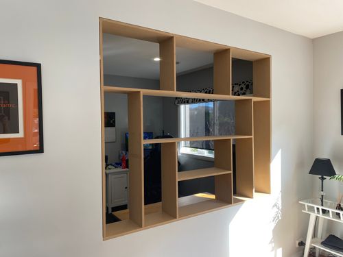

Using the guide attachment on the saw, I cut the lengths of MDF to the correct width. From there, I made the external frame, and all the cuts for the internal shelves. I assembled it on the floor of the dining room, crosschecking measurements/angles etc, ensuring everything was square as I drilled the holes and screwed everything i to place.
crossing my fingers, and praying it would be a snug fit, I asked my son to assist with lifting into place. Using the spirit level and a few little pieces of timber to wedge into the gaps, prior to clamping, drilling and screwing into place.

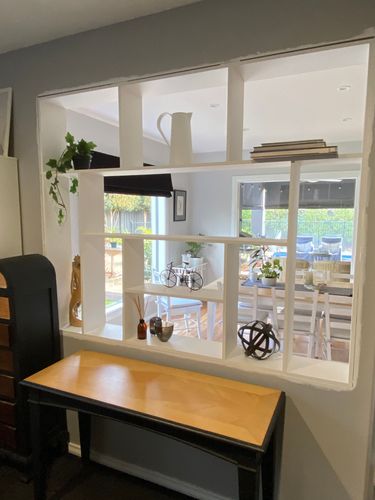

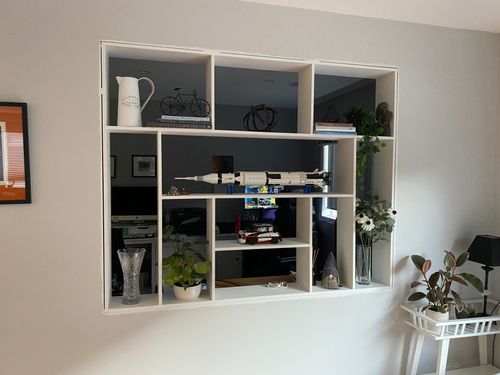

Using MDF, I decided to apply two coats of primer, followed by two top coats. Lots of sanding between coats of paint, and of course all visible nail holes were puttied and lightly sanded prior to first undercoat.
This has been my DIY July project. I have today purchased the architrave and hope to have this installed next week, which will finish off the project. Without the availability of a drop saw, I have purchased a mitre block, and a fine toothed hand saw 🪚 to obtain the necessary 45degree angles.
Feeling proud of the finished result.
