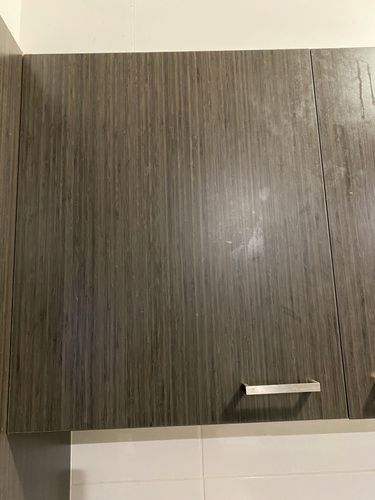

First time poster/DIY’er so any advice is appreciated and please be kind. What type of paint/brand would you recommend to paint over Melamine kitchen cabinets?
We won’t be selling for a couple more years, so replacement is out of the question. Choice of colour White.

You need to use a paint designed to be hard-wearing, and that can adhere to laminate with a suitable primer. The Dulux Renovation range is very popular for this type of project and you'll find this step-by-step guide useful: How to paint kitchen cabinets.

I went in with the Dulux renovation primer today after a good wipe down and sand. Will be applying the first top coat tomorrow morning, so wish me luck 🤞
That sounds excellent, @Krause. A little tip, don't play with the areas you've painted once they start to become tacky. It'll self-level out most of your brush or roller marks, but if you start touching them, you'll pull up peaks and disturb the surface.

@MitchellMc such a great tip, I started to doubt myself after seeing a few roller marks when the first coat was down but after a few hours it really did self-level out as you said ![]()
