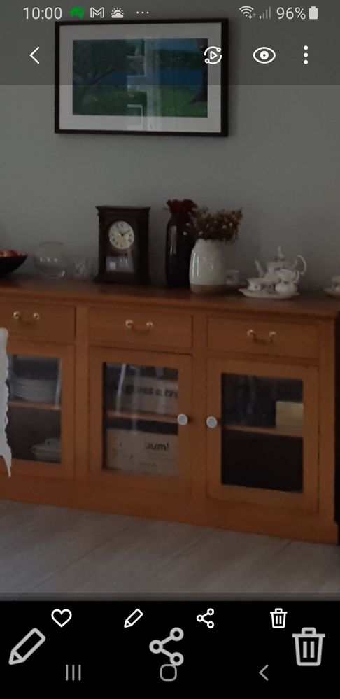

Hi Jason,
Thank you so much for the info. I'll definitely be doing something like what @LizzieCro did as it's just what I'm after.
I'm very much into updating things by painting them so the paint information is really useful. I just finished updating an old side cupboard using Bunnings Paint, knobs and self adhesive vinyl on the glass parts before painting.  AfterAfterBeforeBefore

Hi Sue, @suequarford
I love your re-vamp of the buffet. Something I found which is possible is to just paint the glass. We had mirrored sliding doors in a bedroom, which I was renovating. The mirrored doors didn't suit the new look. I thought I'd take a punt and paint them. Firstly I used silicon and added Shaker trim to the outside of the mirrored section (3mm ply strips). Then I applied ESP to the surface of the mirror, just as I would if I was using it on any other slick surface. Then I primed with Zinsser BIN, then top coats of water based enamel. I honestly didn't think it'd be at all durable, but here we are, 6 years later, and there is absolutely no damage or scratches on that paint. It's in a bedroom which is used by my daughter, so gets no special treatment.
