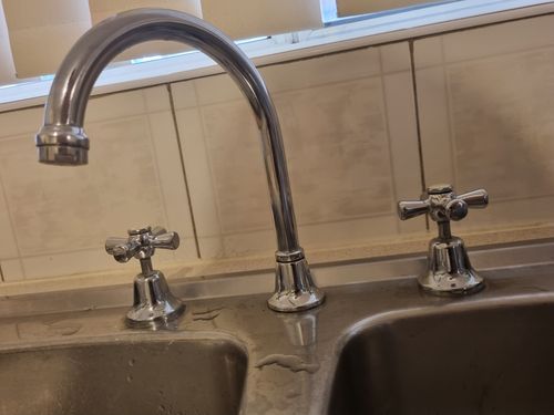

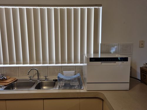

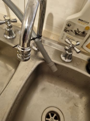

Thank you, I've ordered those bits from Bunnings and will try to set it up next week. Regarding the drainage hose, what do you recommend to get it to stay in the sink? It is quite long and bendy. My sinks are quite shallow, as you can see from the photos.
Hello @clam0618
I suggest using the VELCRO® Brand 25 x 200mm Black Reusable Ties - 5 Pack to attach the drain hose to the tap and spout so that it keeps pointing into the sink. Once you're done using the dishwasher you can release the velcro and tidy up the hose. For a more permanent fix, you can use cable ties to keep the hose fixed in place.

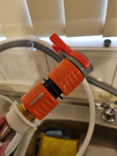

Thank you. I bought all of those parts but I'm not having much luck. When I turn on the tap even just on a slight flow, after a short while the connections burst off the tap. I've attached a picture of the set up. Please help ![]()
Kind regards,
Christine

Hi @clam0618
without my seeing it all in place.... that set up looks like it would be too long to fit into the sink area and would put sideways strain on the top clip fitting. I suggest that you replace the two way coupler with a flexible one which will allow the setup to go out to the side, where there is space for it, instead of straight down into the sink. That should allow the coupler to attach more firmly to the spout.
https://www.bunnings.com.au/pope-12mm-swivel-2-way-snap-on-coupler_p3130619
(I am assuming that the top is where it is coming off after the water is turned on.... ?)

I wonder if something like this diverter could be installed at the sink outlet before the spout, so that the dishwasher fitting could just screw straight onto it and be left connected, with the diverter being shut off when not required ...?
https://www.bunnings.com.au/kinetic-chrome-handspray-diverter_p4790531?
If it could fit, then the spout would sit a bit higher than before.
Just an untried idea.
Hi @clam0618,
If you can connect the fitting securely, I'm not seeing any reason why it would pop off as it's designed to withstand standard home water pressure. Is it possible that you haven't connected the fitting correctly, or it's being stressed as per @TedBear's response? Have a look at the installation video below, specifically the section where you need to squeeze the handle and push the fitting right up and onto the tap adaptor. I'd hazard a guess that you're not pushing the fitting up hard enough while squeezing the handles. The fitting is likely not capturing the recessed section and locking in place.
Please let me know how you go.
