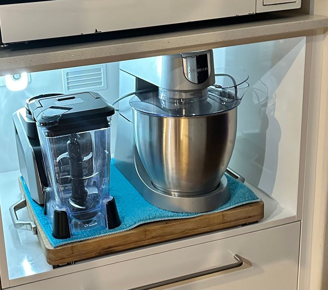

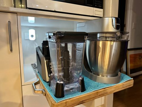

As we began refitting the house we were very conscious of making the house accessible by wheelchair and able to transition with our care needs. The old single person kitchen was enlarged and a microwave nook was put under the counter so that spills didn’t result in burns. After 5 years of grumbling about bending down to reach into the microwave all the time. One day while it was up on the bench for a deep clean of the cabinet we just left it up there.
Being able to reach the microwave at waist height has been a huge benefit for me as I would get vertigo and nausea and would often not end up eating whatever I had been preparing. So the mixers were demoted to the nook and the new grumble was lifting them up onto the counter when needed and then having to put them away afterwards.
So the idea was born about whether we could have a slider put into the nook that could lift the machines up to counter height. After a few months of not finding any off the shelf designs we started to wonder if there was a simple Bunnings trick that could fix the new issue.
There is already a power point and a vent in the microwave nook. The night light is motion sensing and becomes a handy torch in power outages. The chopping board hasn’t been getting much use and fitting the soft close sliders to it has given me the slide out that I wanted and if it just a quick martini I can even run the machines on board. Once a week I make up dog food and so I can release the slider and put the board up onto the bench and just latch it back in when I have finished.

What a great solution to a difficult situation. I love how you used the chopping board as the shelf. Did you screw the runners to the underside?
I'd be keen to see if you could get it to lift it; that would be nifty. If you were to add an additional timber panel on top of the bottom, the sliders could be moved onto it. That additional piece could then have gas struts attached to it in the corners. I think you could then slide the chopping board out so it clears the cabinet and then lift it up on the bottom. The struts would pickup the added shelf. Lowering would be the reverse. It might take some work to get the struts to function correctly.

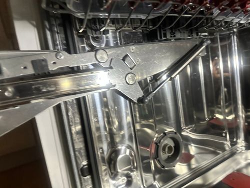

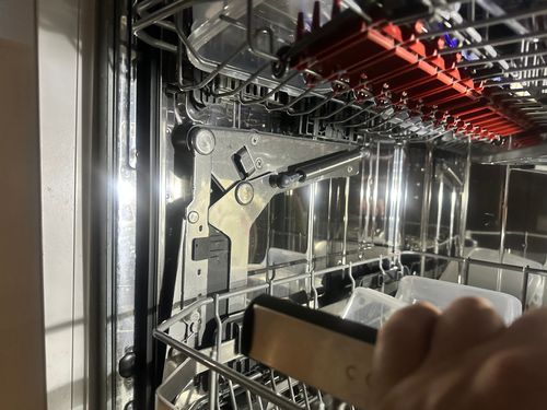

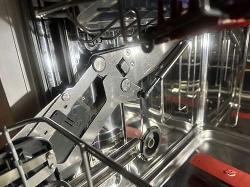

I had a look at how the lower draw of our dishwasher lifts the tray up to our drawer height so we can transfer the clean dishes back into drawers without having to lift or bend. I guess there is some design patent issues to copying it but I can’t even work out what it is doing other than something like an etcha-sketch and machano had a baby.
