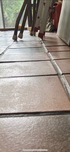

Hi @argylepink
i know it’s a long time since you first posted this but wondering if your tiles are similar to mine (see pic) and what you ended up doing.
cheers!

You could use a self levelling compound and then lay hybrid/SPC (waterproof) flooring over that @BobLoblaw
When tiles have big (deep/wide) grout lines, it's easy enough to fill them with grout then lay new hybrid/SPC/laminate floorboards over the top of them. And if you have a few tiles that stick op more than others, just grind them back.
However, yours looks like a combo of both, hence my suggestions to use a self leveller first - this will cover/remedy the whole floor.
