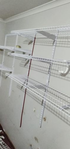

What screws and anchor are best to use when installing wire closet on bedroom wall. I can't find the beam. I want it to be strong and secure. I also hope for easy tools screws and anchors.

Could you perhaps provide some information or a picture of the wire closet so we know what type of weight it will be supporting? That will assist our members in advising some great solutions.

Thanks for the photo @gteam.
As per Mitch's reply, we would encourage you to check out the  Ramset Wallmate products for fixing it to plasterboard. Let me tag the ever-helpful members @Tara86 and @Brad to see what they would choose for the job.

I put a lot in at times so I have gone down this path -
ramset-hollow-wall-anchor-setting-tool

Thank you so much. I think I will definitely be getting the anchor setting tool.

Thank you I want to order one. Could you please tell me what the name of the screws I need to purchase to use with the tool.

They are called Hollow Wall Anchors.
Ramset M4
Ramset M5
Ramset M6
There is also some carded product that misses the searches based on size.
