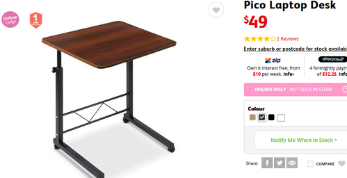

"I have attached a photo of what I am aiming for!"
Would it be simpler and cheaper to just buy that desk?
I remember years ago building this little adjustable height desk that was fiddly to build and then there was the cost of materials including metal, wood, lacquer, et cetra and then discovering a similar looking product recently on the Fantastic Furniture site.
It looks better than mine and at a fraction of the cost.
Just a thought.

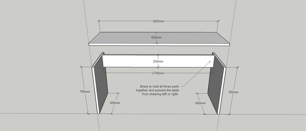

Hello @stefplavoulis
You can build this using AraucoPly 2250 x 600 x 30 clear pine FJ Laminated panel. 3 x panels conservatively. How you join it together will be the the thing to think about. There are over a dozen types of joins you can use from simple butt joins to mitered channel joins. You may want to use heavy duty decking screws to join these thick pieces of timber together to prevent swaying and shearing. I suggest looking up paint finishes in google in order to achieve that tough high gloss finish your aiming for as there are ways to paint it in gloss but you want the finish to last and be tough for day to day use. It all comes down to how complicated or simple you want to assemble this table. Below are the suggested measurements for you to achieve the picture you posted.
Cheers,
