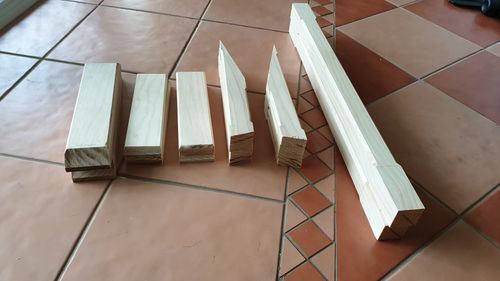

Hello,

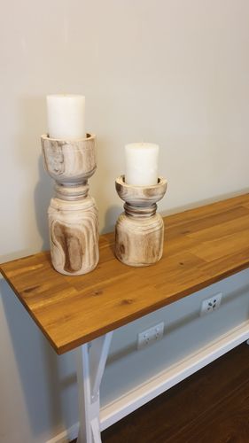

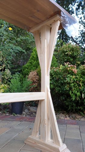

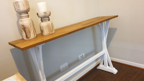

Just sharing a project I did over the weekend. It can be easily adjusted to suit whatever space you are looking at.
The utility panel I used for this piece is 1200x300.

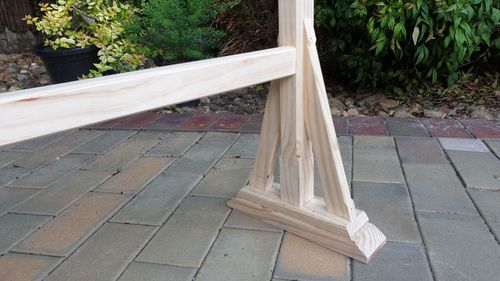

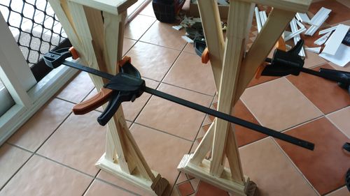

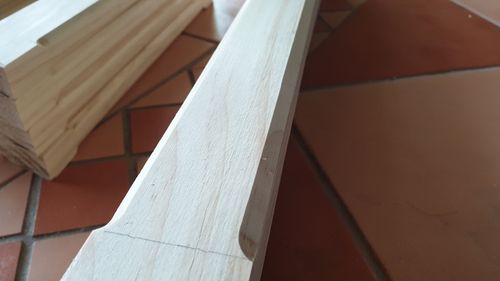

Some build photos

That is super cool, @loggie! I absolutely love the work you've put into the legs, as it really makes this table shine. However, I'd likely give myself a headache trying to work out the angles needed. Where do you even start to work out the angle of cut and approach for the leg supports? I'd be able to estimate the angle I needed where the support meets the leg, but how do you work out the other angle that meets the top or base? I suspect if I paid more attention to high school maths, this would be a relatively simple equation to work out.
Many thanks for sharing this truly unique console table, as I trust it will bring many of our members some fantastic inspiration. Well done.

Thanks for your kind words @MitchellMc
The base is quite straightforward once you break it down. Because I wanted the width of the base to match the width of the utility panel, I went with a 15 degree cut at the bottom. the top would then be 75 degrees (subtract the bottom cut angle from 90 degrees, so in this case 90-15). I did a mockup in Adobe Illustrator to identify the lengths of the cut based on the dimensions I needed it to be.
I'm guessing it would be easier to do it if I use a 3D modelling tool instead of Illustrator. Do you have any suggestions on something easy to learn?
I just realised the image was slightly inaccurate. I removed it for now - will update shortly
