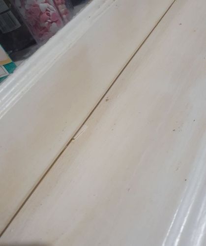

We spent a small fortune on Porter's Chalk a few years ago painting furniture and sealing it with their polyurethane product. Now that time has elapsed - we would tackle things differently.
In the end it had a rather poor surface durability.
The instructions say you can apply it to pre-painted/stained/varnished surfaces without sanding prior but our experience showed these coatings did leach through the chalk paint over time.

I think that's what we should have done, but we were tired and lazy at the time. I think the results would have been better appearance wise but I still doubt the durability of the sealant we used - I think it was a Cabot's polyurethane product.
This is six years later - looks 'dirty' but that's the varnish/stain slowly leaching out. I just tell observant lookers that it's the new rustic approach to chalk paint. 😁
