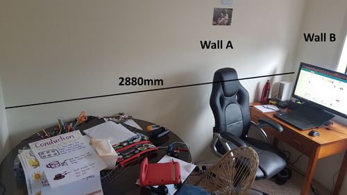

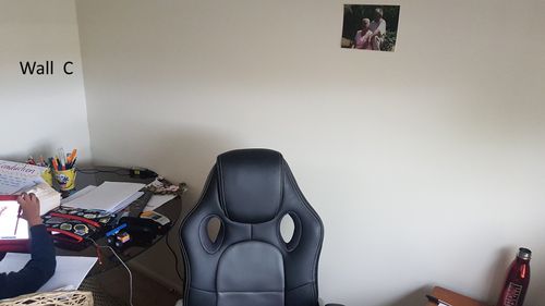

Please excuse the mess. Two teachers in the house, so we had to quickly set up for remote learning.
So I want to attach it along wall A all the way across from wall B to wall C. I have got a stud finder but finding it difficult to find the stud in the wall at the moment . Thanks for all your help, guys. Hope this helps, @ProjectPete. I looked at what you did with your project on the floating shelf. It looks very nice. I tried to go on your insta to see the finished product but couldn't see it.

Have you considered getting a single piece of timber to avoid the join which requires extra effort and cost and obviously isn't a seamless?
Those brackets sound like they'll be strong enough, my only concern would be the fact they support less than 50% of the depth of the desk (250mm of 600mm). Either way, I'd pop one of these on each of Wall B and C. And it wouldn't hurt to pop one of the corner brackets shown in pic below in each corner.
