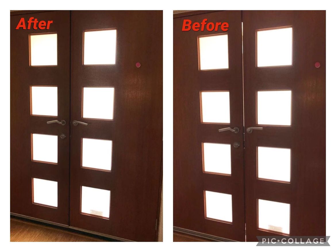

Hi online experts
My door has big gaps in between, how can I fill up the door gaps, it is very bad during whole year, very dusty, sandy and windy, could you show me some methods to solve it out

Please find attached the photo the size of the door, do I still use the tape you suggested for me
Hi Maymay, I just had a much closer look at your earlier pics, where it appeared that the door was damaged, but isn't... I see that someone has put some sealing tape (looks like felt tape) along the bottom of one door's overlap, but on the wrong surface. I think that this is what is stopping the door from being able to close properly. Sealing tape must go on one of the faces that would touch each other. Ie a face that is in line with the glass. The tape I see is in line with the wall. This will make it hard for the door edges to slide past each other and close properly, and even if it doesn't, it won't provide any seal there anyway. Remove all of that tape and replace it with that which @MitchellMc suggests, but it must go on the bit that sticks out from the doors, so that the corresponding flap on the other door will press against it and seal any gap when it closes.
Yes! I got it, it was me to put on the wrong surface and wrong tape, I will remove all the old stuff and fill it again
Thank you very much
Best regards
Maymay 😊
Glad to know that there is a solution at hand. Hopefully a more comfortable winter without a gap between the doors 🚪🚪 🙂. Cheers.
Thank you and Mitchell for all of your advice and information, I am glad to tell you I just finished to fill up the gaps, it was too windy, dusty and sandy since the door like this and hopefully coming year will be very happy
Many thanks
Fantastic work @Maymay! That looks very well sealed now, and you shouldn't expect to see any dust and sand inside. I'm sure @TedBear will be equally excited to see your finished job.
Many thanks for sharing your results and well done.
