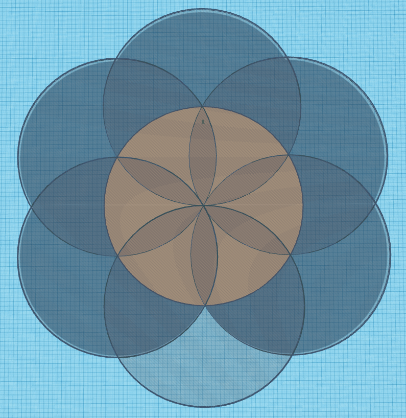

What's your geometrical method of placing the leg plates perfectly equidistant to each on the round table top?
I've messed it up many times.
I'd use the very scientific and highly accurate method of crouching down next to the tabletop, forming an L-shape with my index finger and thumb, peering past it with one eye closed, and positioning the legs before stating out loud "That'll do".

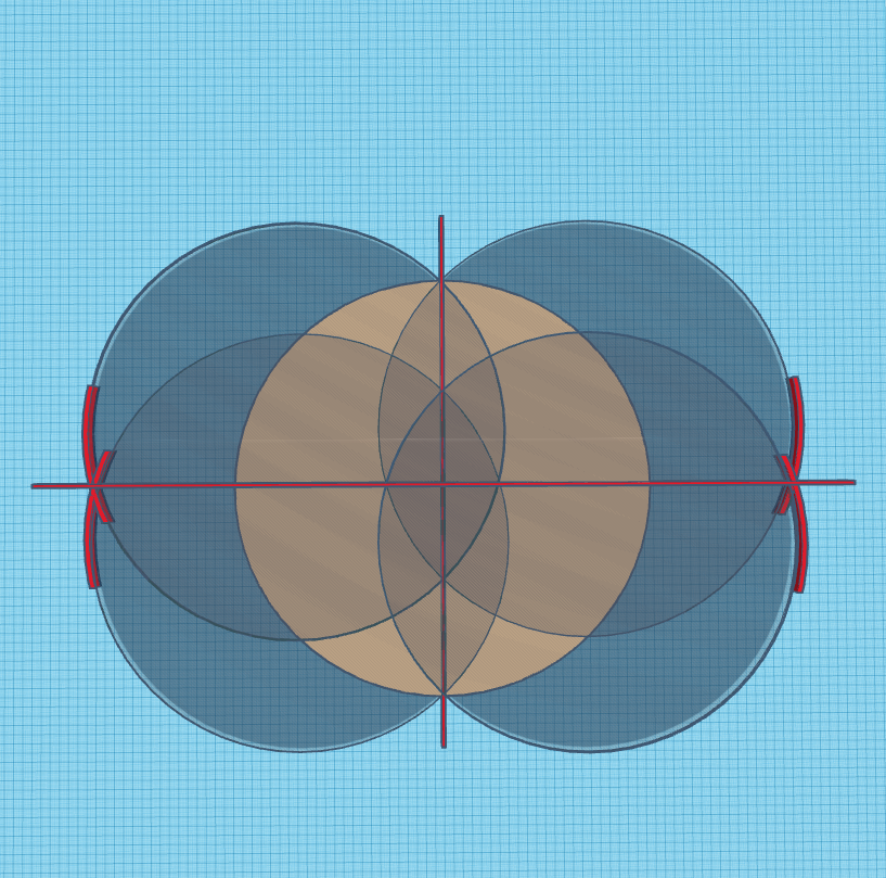

In all seriousness, though, it's incredible what you can do with a nail and a piece of looped string. You can get a very accurate segmentation of a circle that way. Thirds are easy, pick a point on the circle's perimeter and measure your string to equal its radius. Jump around the perimeter marking points. You'll get six segments, then pick those in-between. Dividing into fourths is a little trickier, and you need to mark outside the circle. I'd generally just use a straight ruler for fourths.
I'm sure there are myriads of different online calculators which can be taken advantage of if you need precise measurements. As mentioned above, for something like table legs, I just eyeball them.
