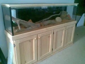

Here are some photos of the fish tank stand that I made for a family member.
I did not take any photos of the original build.
The low res and small photos were taken with a earlier digital camera at a later date when little mice critters replaced the fish and I had to make two top mesh frames.
As @MitchellMc mentioned the stand needs to be very strong, I braced the front corners (top & bottom) with heavy duty brackets and the back is braced with 70 x 35 like a X - bottom to top corner.
With hindsight and to mitigate a flooding event (which happened) I should have used pavers to raise the tank off the floorboards.
