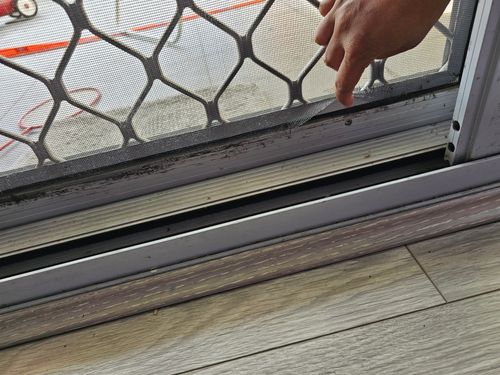

The fly screen for my security door to Balcony is damaged (kids!!). I trued patching up those stick fly screen patches but the come off as soon as slide the door to open. Any other solution? The bottom bit of the fly screen has come out of the frame. And tips to change the fly screen myself please.

Thanks Eric. Sharing some pics. Mostly the damage is near the frame only

Thank you for sharing those pictures of your screen door. It appears that the flyscreen has deteriorated at the edge and needs to be replaced. I suggest measuring the height and width of the screen door. This will give you a good idea of what screen size to get.
On your next visit to the store, I suggest cutting a bit of the old screen off and bringing it with you so that you can compare it to the flyscreen at the store. In this manner you can be sure that it is similar to the one that you currently have on your door.

If it looks like the rubber spline is brittle, I suggest cutting some off and bringing it with you as well and getting a new set. To help with installation, I recommend getting a Cyclone Tufflite Synthetic Spline Roller

Thanks a lot for this. I was successfully able to replace the fly screen.
