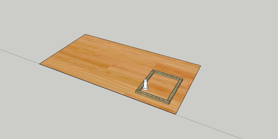

Let me tag @nagumuthu to make them aware of your suggestion. Using a router would definitely give you a very tidy edge. It also lessens the possibility of edge tearing and getting a jagged finish on the ends. To make it even tidier you can build a makeshift guide to give you the perfect rectangular cut.

Hello @nagumuthu
The make-shift guide is actually just four pieces of timber joined together with screws and arranged in a rectangular fashion to guide the router while you are cutting the hole. I've placed an image below to give you an idea of how it is done. The timber frame is kept in place by clamping it onto the MDF board.
Please note that the timber guide needs to be adjusted to the size of the hole you'll be cutting.
