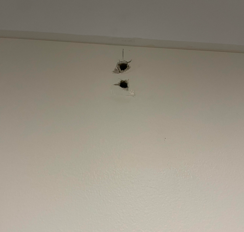

I've this issue where the old anchor & screw that held the curtain rod came off and I'm left with a big hole in the drywall.
I need to fill up this hole so that I can add the anchor and screw in the curtain rod preferably back at the same position.
Attached is the image showing the hole in the wall.
Any ideas and suggestions on how to address the situation is highly appreciated.

Hello @newuser
Welcome to the Bunnings Workshop community. it's fabulous to have you join us, and thank you for sharing your question about repairing holes in your plasterboard wall.
Generally, I would recommend using Parfix 500g Ready To Use Multipurpose Filler to fill in the holes in the wall. However, this situation is a bit different as the repair spot will be carrying weight.
I recommend trying this repair method.
Once you've covered the rectangular hole, I suggest filling in the cut edge with the multipurpose filler. Allow it to cure before you begin sanding it down. Once it's nice and flat, wipe the surface clean and you can begin painting the repair spot.
The advantage of this type of repair is that you can screw directly into the repair spot as the curtain rod end will be anchored into the timber piece behind the wall.
I've sketched up basic steps to give you an idea how to do the repairs.
I also suggest having a look at this discussion - How to repair plasterboard damage? by @lavanya.
Thank you so much for your reply. Will try this method out.
