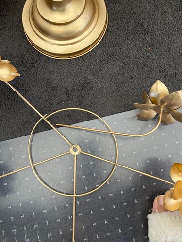

Please suggest how to fix the broken mental piece
Good morning! @jyoraniga 😁

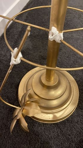

For me - I would be going down the welding path. It looks like the upright unscrews to reveal that 'mobile' insert? Hard to tell with the blue-tack(?)
I do see spot welds in your photos, so it's doable. Do you or anyone you know weld?
My little inverter would be set at a low amperage (~70 amps) with a 2mm rod. Just enough for a small spot weld.
Tap any slag off and clean the weld with a wire brush.
And you would need to repaint the area with a similar gold colour.

It's great that you've received excellent advice from @Noyade. Just to add to the suggestions made, I recommend having a look at PC Products 57g PC Metal Epoxy Putty. Looking at the photo you posted it seems an attempt was made to repair it using a similar product. This product that I've suggested is specifically made to repair steel. Please note that it has a very short handling time, it's important that the parts are ready to be joined together as soon as you remove the putty from the container.

In the end - arc welder, 60 amps and 2.5mm rod.
