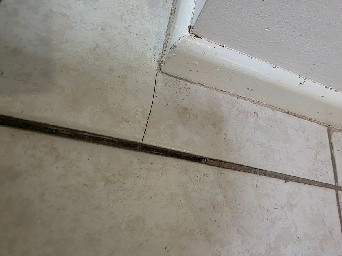

How to fix lifted floor tile?

And do you know what floor base you have underneath the tiles? Is there other evidence of the house foundation moving, such as cracked walls? I'm sure other members will say that you might need to fix the cause of this issue first rather than just the outcome...

To be honest I dont know whats underneath the tiles... Im guessing its concrete LOL.. Definitely there is no evidence of house foundation moving.  So no cracked walls.  I do hope to get anyone even if they know how to fix this really.  Any ideas would be nice cause I am out of ideas.. I am guessing cleaning out the concrete and bang the tile down??

I am guessing.. remove the tile, remove the cement/concrete... remove the gout thing on the sides.. then clean it up whatever thats making it looks unpleasant.. then put the new cement or concrete thing.. put the tiles on top.. then when dry put the gout on the side ?  Thats my guess really LOL.. I have no idea.  Just what I saw on youtube really.

That sounds like a good plan above @MsChume
Is it possible the tile was never installed correctly from the word go?
Please keep us posted with progress photos.

No I dont know that idea LOL... when I bought the property it was like that already LOL.  I dont even know how long it has been like that to be honest. LOL.  If I manage to do something about it il l let you and all updated LOL!!

As Jason has alluded to, there is likely a reason why this tile has popped up like this. You've got the basic steps down pat. Take a grout saw and cut through any remaining grout around the tile. Gently lift it and check out what is going on beneath. If everything looks alright, you can chisel off some of the old adhesive, add new adhesive and bed the tile back down again. Once the adhesive is dry, you can re-grout the tile.
Here are some handy guides: How to remove tile grout and How to lay floor tiles.
