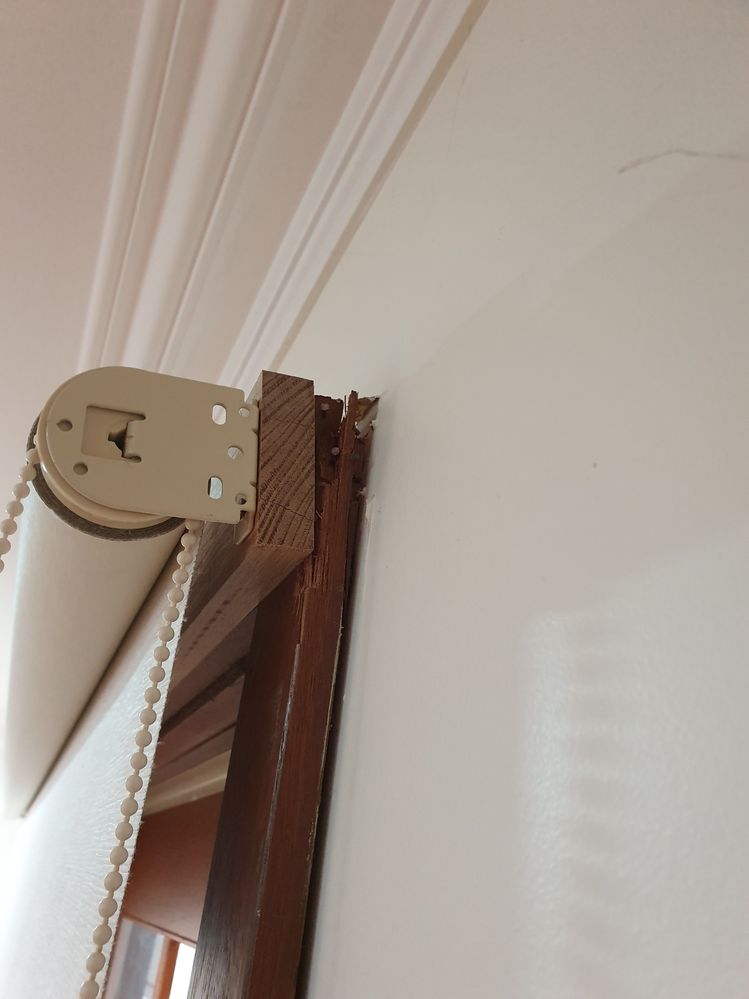

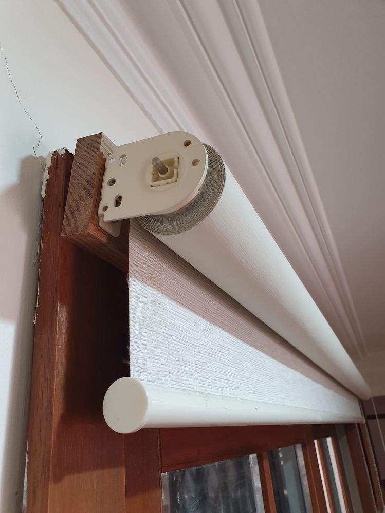

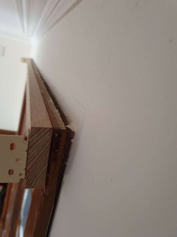

Hi bunnings workshop community,
We have a problem with the curtain structure on the wall in the living room, it is very fragile, can break any time. Can you help? give me an idea how to fix it?
pictures attached.

I suggest carefully removing your roller blind from its current location and putting it somewhere safe. Once you've removed your roller blind, can you please take a photo of the mounting brackets and how it's screwed to your window trim. Is your wall plasterboard or concrete/masonry? Once you provide us with the information about your wall, we'll be able to give you recommendations on how to repair your roller blind mount.

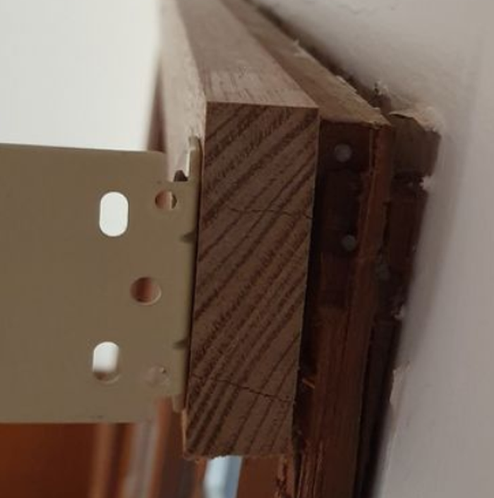

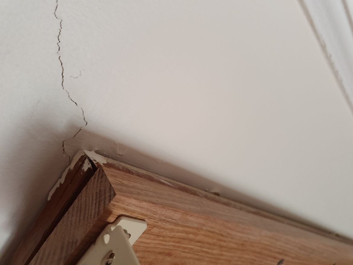

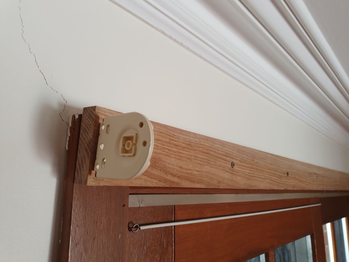

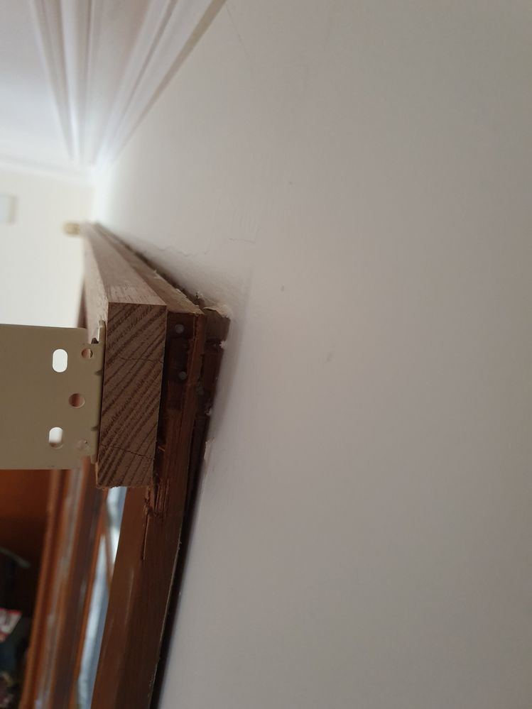

Thank you for posting those extra photos of your roller blind timber mount. I propose removing the timber piece that is attached to the trim of your window frame. Put this aside for a moment and look at the top trim of the window. Do you see any other screws along this piece of timber? If you don't see any, I propose putting a screw on the end of the window trim at the top. If the screw goes in past the plasterboard and into the windows timber frame, you should see the timber trim get pulled to the wall.
If that happens, I suggest putting another screw on the other end and two in the middle evenly spaced apart. I've placed a sample image below to give you an idea of how to anchor it back to your wall. once the trim is secure screw the roller blind timber back into place. The roller blind holder should now be secure, and you can re-install the roller blind itself.
I suggest using Zenith 10G x 50mm Countersunk Rib Head Chipboard Screws when securing your window trim.
G'day Eric @EricL
I was wondering why someone had attached that additional piece of wood. I originally thought it was to project the curtain a little further away from the window, but looking closer - the top right mitre joint appears to be shattered with at least two nail heads exposed. Hard to tell, but based on that bracket's position, someone had determined there was no longer any viable wood to screw it into. In fact, even that new piece has split with the screw placement.
See what you think.
