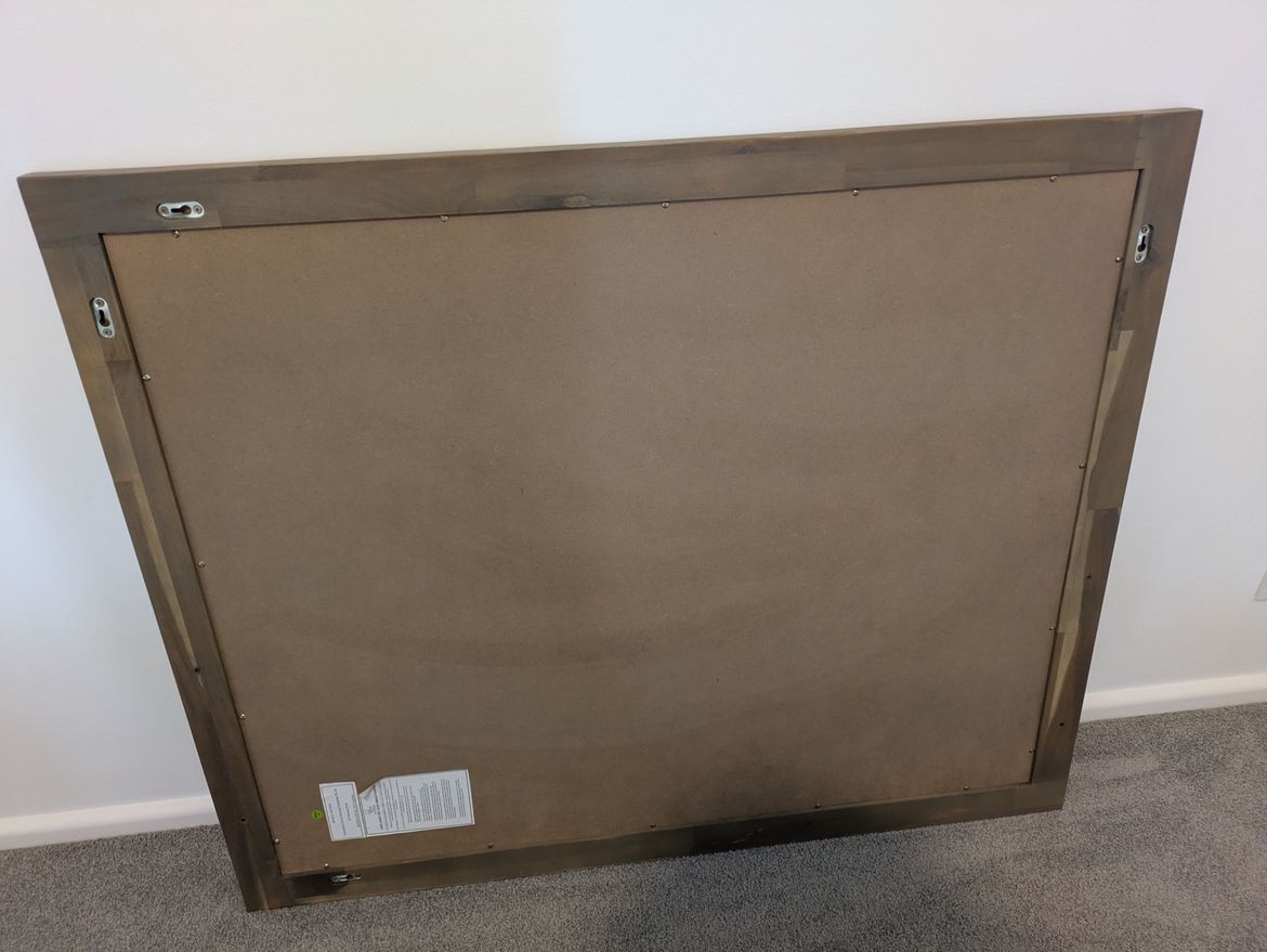

I have a mirror 13kg (1.2m x 1m), which I'd like to hang.

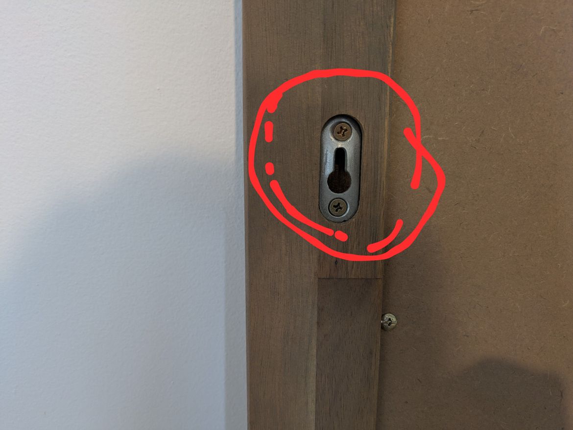

I have marked on the photo the fixing-gap which is already on the mirror frame. This mirror used to be mounted onto a dresser. there were vertical uprights on the dresser. We had bolts which slotted into the gap on the mirror, fed the bolts through the vertical upright and attached a nut.
Ideally, i'd like to use these existing 'gaps'.

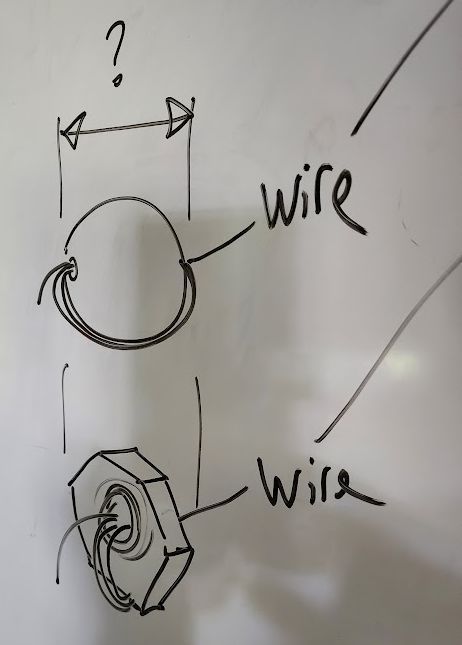

I'm wondering if there is any sort of fixing i can attach to this gap, and then attach picture wire to?
Also, is picture wire strong enough for a 13kg mirror?
