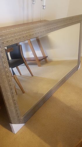

Hi @Serveh
31kg sounds epic. Do you have a photo to share?

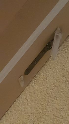

why is it you can’t use a stud? Is there a hook on the back of this mirror?

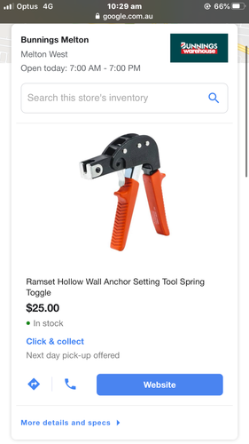

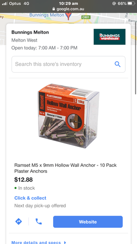

if you want to hand anything from plaster I highly recommend this tool and the anchors.
@LePallet thank you. This is the mirror and the hook. Studs might not be at the right place to center the mirror 🙁
I have used the wall anchors with the setting tool and for my last job Wall Grabs by Macsim rated to 20kg in plaster just needs a No.2 square drive, I put them in with a screw driver no and need for a pilot hole in plaster type products just don't overtighten them as they would strip fairly easily.

I've just made contact with Zenith about the Zenith 40kg Zinc Plated SurehookStud Free Picture Hanger and they have qualified that hook is suitable for holding up to 40kg in plasterboard. It appears you have a couple of fitting loops and using two of these hooks to support the 40kg would be more than sufficient.
