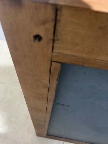

Could you show us these pre-drilled holes in the mirror? That additional information will assist our members in providing some helpful advice. Do they go all the way through and is the fixing designed to go through them?

I’ve uploaded a couple of pics of one the holes.

I'd suggest drilling holes into the brick at your six mounting locations and fixing Ramset 7 x 35mm Green Wall Plugs into them. The mirror frame can then be mounted using Zenith 10G x 75mm Zinc Plated Countersunk Head Wood Screws. It looks like you are missing the Zenith 10G Chrome Plated Screw Cup Washers that prevent the screws from pulling through the timber frame.
@Noyade's idea of using the expanding hollow wall anchors could also work. I'm just a bit concerned that there is not enough room for them to operate in the cavity. The thickness of your frame will determine the length of the anchor needed. If the frame is thin, then these could work. A Ramset 16mm Hollow Wall Anchor would likely work, but is your frame thicker than the 16mm screw provided in the anchor? I'd presume you'll need something more like the Ramset 24mm Hollow Wall Carded Fastens Anchor, but I think the anchor will bottom out on the brick before it's full inserted and able to grip the plaster.
