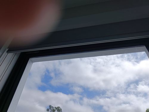

I have this stegbar awning window which comes with a single channel at the bottom. There are no other channels on the sides and the top.  How can I secure a flyscreen to the window? What sort of clips do I need? Thanks.

If this doesn't prove fruitful, then we would need to find a way to mount aluminium channel around the opening so you can insert a flyscreen. You can see there are channels on the side that can be used, but we would need to add the channel along the line I have added below and at the top of the opening.
If you can let me know what the width of the channel is on the left and right of the window, I can recommend a suitable aluminium channel.

It may be the shadow, but it looks like there is a usable channel that I have marked below.
If this is not the case, then you should add them on all four sides of the opening.
