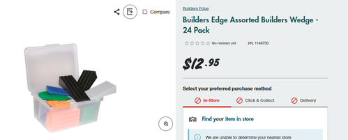

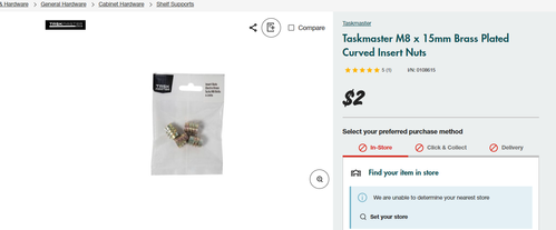

Bunnings sell these inserts, you to drill the base to insert these nuts. Another way would be to make some timber packing or wedges (see image below) to make the cupboard level.
