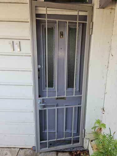

Though here are some photos of the security screen door

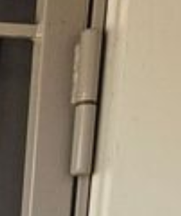

Looks like a welded steel frame to my eyes @niknak5544
With serious looking welded drop-down hinges.
Try the magnet options discussed above.

Re: DIY magnetic flyscreen for security door
I'd agree with @Noyade that the screen is most likely to be wrought iron, @niknak5544, which is magnetic.
Good afternoon @niknak5544
Id have a go at the magnetic ones mentioned as well :smile: You could check by using a fridge magnetic and see if it wanst to stick :smile:
