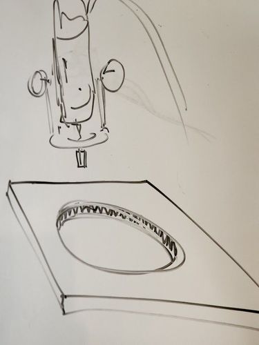

Possibly a silly idea, but - experiment with a template and a plunge router to get the diameter you want?

@Noyade, that sounds a great idea. I know router is versatile and can get many jobs done. Just I don't have a plunge router, and I am a beginner, feeling router is bit dangerous and tricky to handle.
