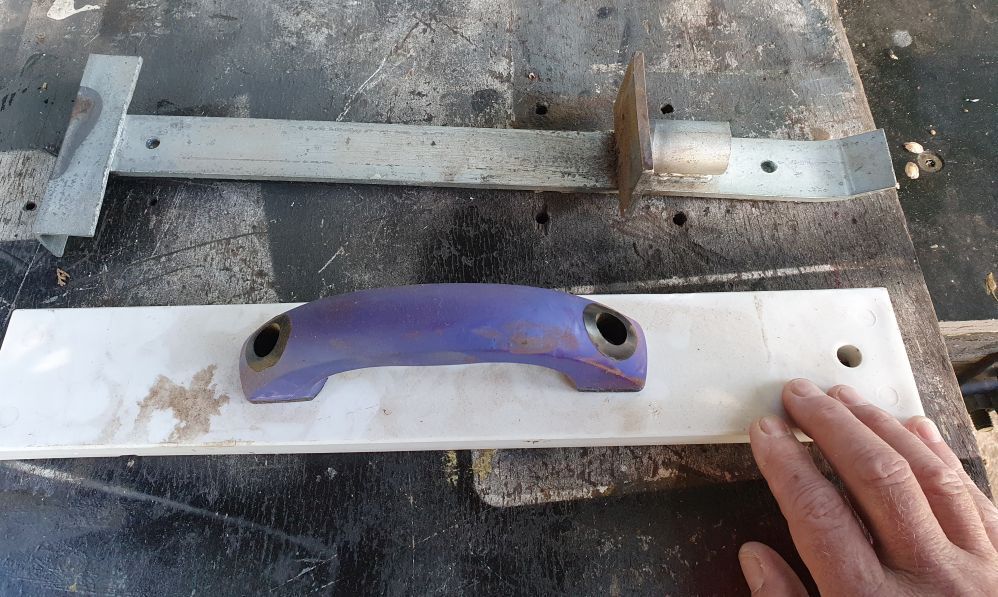

My wife and I laid the floating floor in our house. We are and will remain complete amateurs in life and by the time we finished we agreed we would tackle the task differently should we undertake it again.
But there were two things we agreed on and will take to our graves as the best decisions we made during the process.
Ditch the scotia. Remove the skirting boards and undercut the doorways with a panel saw. Plenty of youtube videos out there to show you how. You will never regret it.
Secondly, we purchased that Capitol Laminate Instruction Kit and before we were halfway into the first room we tossed it into the bin and looked around for more robust tools.
We eventually found some, and again you'll never regret it if you do likewise.
Cheers
Graeme.
Much, much better.Much, much better.
