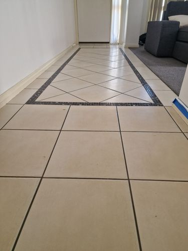

Hi, I'm looking to transition our landing flooring from tiles to hybrid flooring. I'm looking for advice advice on how to protect the carpet and skirting boards from the compound. Hope you guys can help! Thanks

Applying a length of painter's tape along the base of the skirting boards should be enough. As the self-levelling compound will only be 5-10mm thick, then this will be plenty.
For the carpet edge, I'd suggest sticking a piece of Moroday 40 x 3mm x 5m Small Adhesive Seal Roll to the outside vertical edge of the tile and placing a length of Timber behind it to hold it upright.
You should then seal the front edge with silicone to ensure the self-levelling compound does not leak between the tile edge and the rubber.
Once poured, this can all be removed to leave a relatively clean finish. Any imperfections to the edge can be covered with a transition trim.

Is there a reason you are going to use a leveling compound? I have seen a few people lay their hybrid flooring on tiles with no backing as well as a masonite layer inbetween to smooth any ruffles.
Hybrid flooring installation over tiled floor
How to install hybrid floor over tiles? This link opens to a question of the same type of thing from this week. There are a few links that are shown that could help.
If the tiles are too high to be smoothed then yes I would start to think of a leveling compond. Then I would follow @JacobZ recomendations.

I can't add any further advice to that of @JacobZ to essentially damming off the carpet area. Though levelling compound is reasonably thick, it does have the ability to ant small gaps to make's it's way through. So, really take the time ensuring you have created a very good seal.
My other tip from laying floating boards over tiles is to use a long straight edge like a spirit level to find any high-points. Though on the surface they may look even and flat, the smallest high-point on a join can be very problematic both in the install and longevity of the join. Intersecting tiles will be the most likely spots. If you find any, use a diamond cup wheel on an angle grinder like this one. They are available for different sized grinders and price-points. But this was the one I have. The double row design produces a faster and smooth finish. Just be aware that they produce a lot of dust so holding a workshop vacuum hose near the work will make a big difference in keeping the dust down. Just don't use your domestic vac as the dust will damage the motor.

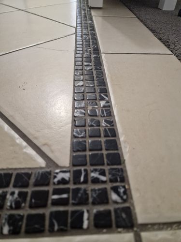

Thank you for your advice, the tiled floor on our landing is very uneven due to the black, small pieces of tile decoration as you see in the picture, it might cause some significant elevation on the floor but I think the leveling compound is the best option other than removing the tile flooring.

Just take your time getting the levels right @ralphvincentpan
There is typically only 1-2mm at best tolerance in levels for the boards to connect. If you’re out of level the thin connectors edge will splinter off. I can’t stress the importance of working to a flat base more with floating floors.
Use thin cardboard as packers for low lying areas.
Those raised black tiles you mentioned to @Dave-1 should be removed. Then layered strips of mdf to fill the space level to the top of the tiles. Then use tacks to fasten them to the floor.
