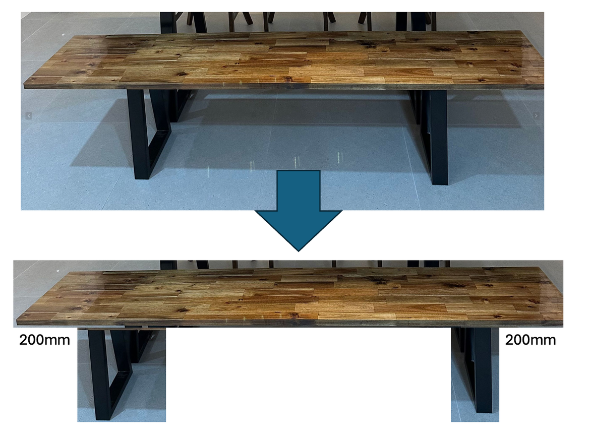

hello Team,
I created this bench as a Dyi with acacia panel and coffee table furniture leg, both of which were from Bunnings itself. However now I notice that if I sit of the edge of the bench, it flips. I think it’s common but I want to avoid any accidents. I can’t bolt it to the floor but I’m looking for solutions to prevent the bench from flipping.
my thought was to move the legs a bit nearer to the edges but I’m scared that will bend my wood in the middle. I wouldn’t want to add an extra leg in between, so maybe a beam below the bench and bolt that up to prevent the bending of wood ?
any suggestions are welcome to prevent flipping this bench over. Thanks in advance!
