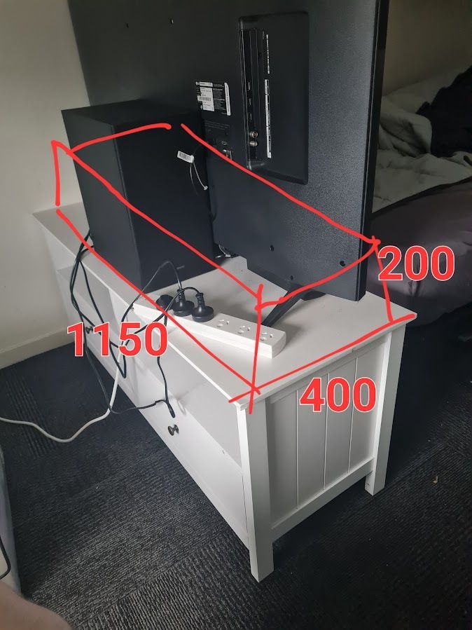

I'm looking for ideas to extend the height of the TV with the dimensions below.
This is cramped University accommodation.
The main criteria is it must be able to be transported on a bus in flatpak mode and then reassembled on arrival.

He wants something that can be placed on top of the existing cabinet extending the height by 200mm for the TV - better viewing.
I was thinking two specrite boards (8.4 kg) with some sort of spacer/s?

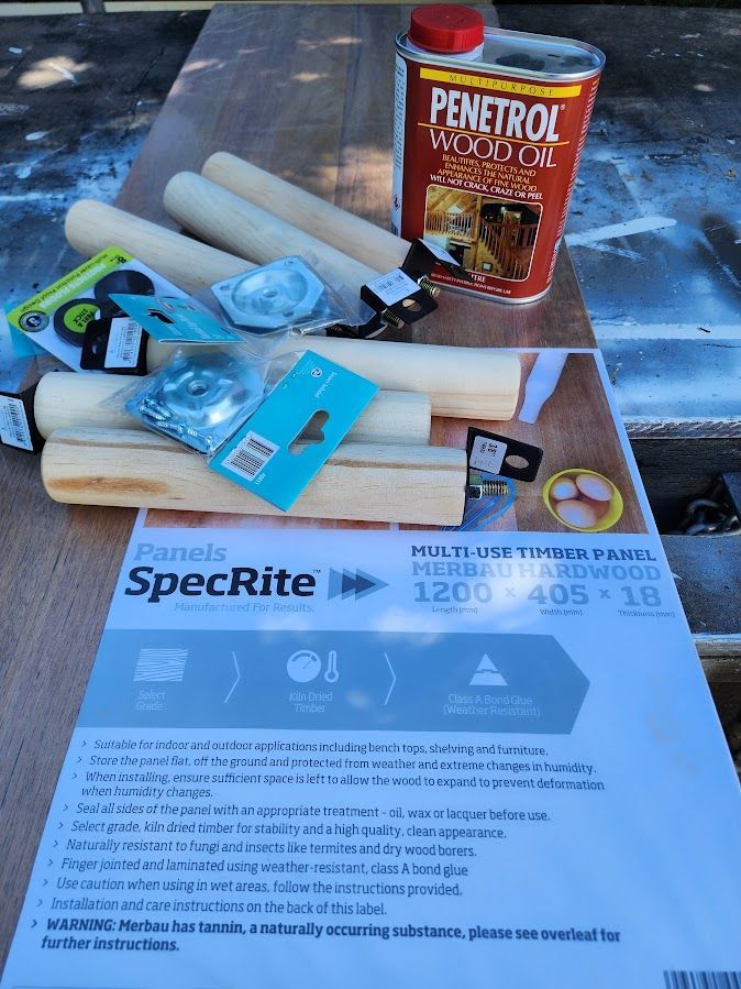

I'll try the 6-legged table.
Heading to Bunnings soon - I'll keep ya posted.
"I love him @Dave-1 - but not that much."
I take that back - he's a good lad, so I bought a nice piece of Merbau instead of pine.
And a big thumbs up to the Bunnings staff members of Aisle 10 - who helped me find the sixth leg.
Cheers!
