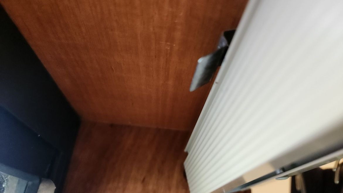

I am trying to remove a vertical blind bracket and it refuses to budge. I have pushed back the release clip at the back and the back of the bracket is released but it refuses to come off. It feels like it is still fixed somehow at the front of the bracket. Does it just need some brute force or am I missing part of the process that looks so easy on Youtube. Photo shows the bracket released at the back. Thank you.
Thanks for tips everyone and I got it sorted. A sneaky middle bracket which I didn't see coupled with some stubborness at the front of the blind where it clicked into the bracket sorted with a sharp tap with a hammer!
All three blinds now removed!

Thanks for sharing your question about your vertical blinds. I suspect that the bracket holding your blind needs to be pushed while you are removing the blind. I suggest getting an extra pair of hands and see if by pushing the clip at the same time and pulling at the bar will dislodge it.
However, if you are no longer going to be using the blind, then I suggest using a piece of timber and wedge it at the top to pry it loose.

Trying to take my brain back to the last time I trie dto remove a blind like that... I remember it was a pain and knew I wasnt doing it right,
I think all clips along the length need to be released and out at the same time and that there is something in the middle....

How many of the hidden brackets do you have? @EricL suggested two people and I am heading towards that idea, one person either end and release from the front, bend down and then release from the back (still have that niggling thought of the middletho) Your blind looks ridgid and I am thinking maybe thats why it dosnt want to roll out of the clip so easily.
Hi @DIYHaveaCrack , did you get anywhere with the blind removal? If not, I am wondering if you can get your phone camera, or a mirror, up there to see what's going on with that bracket. It should be a matter of twisting it down at the back & moving it towards the back to release it from the front hook.
Thanks yes! A sneaky middle bracket which I didn't see coupled with some stubborness at the front of the blind where it clicked into the bracket sorted with a sharp tap with a hammer! ![]()
